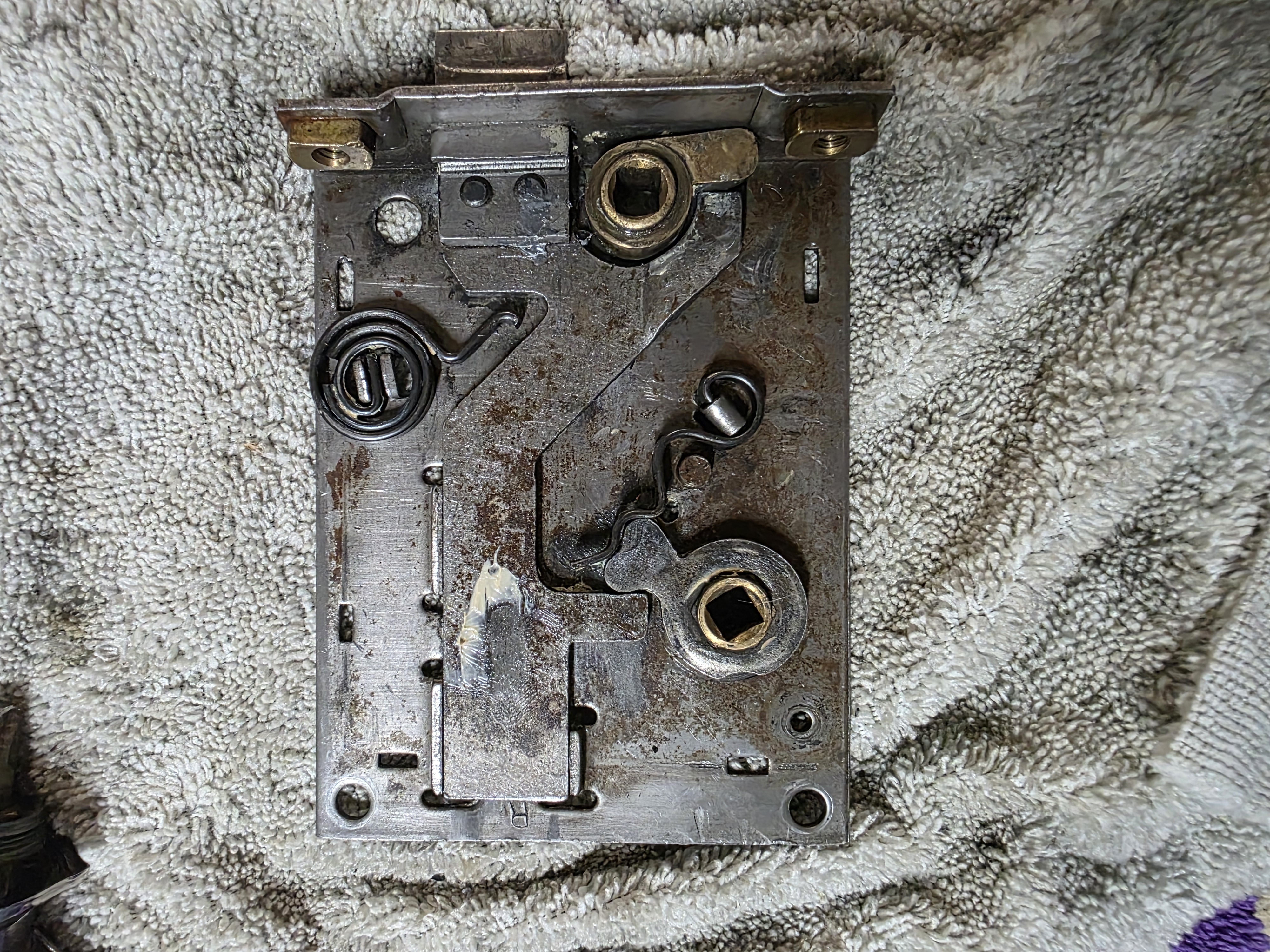

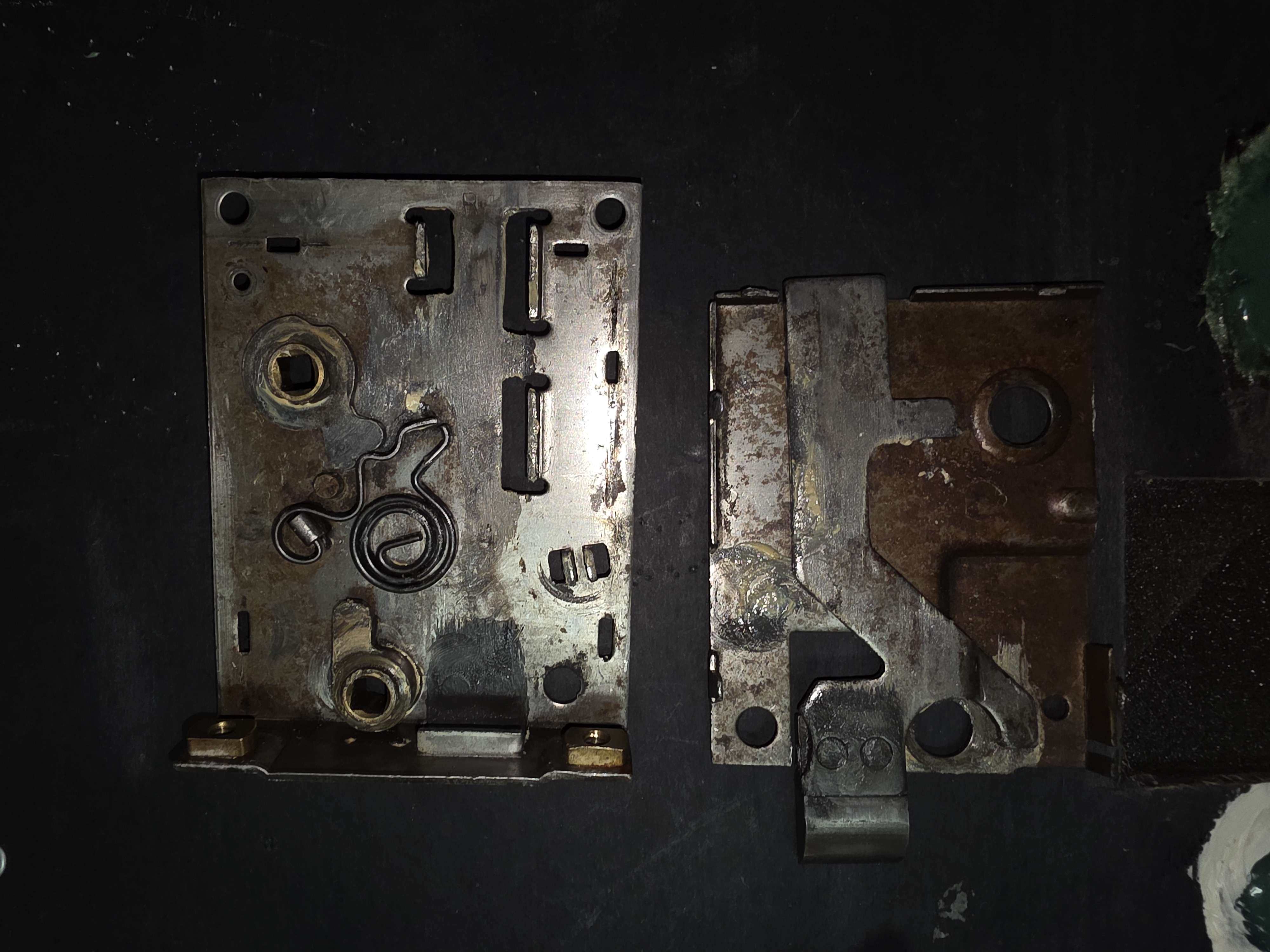

COIL SPRING INSIDE HAS BROKEN
Are you able to take photo - is it in shape of spiral flat coil with ends that hook on to housing? Gert (retired machinist)

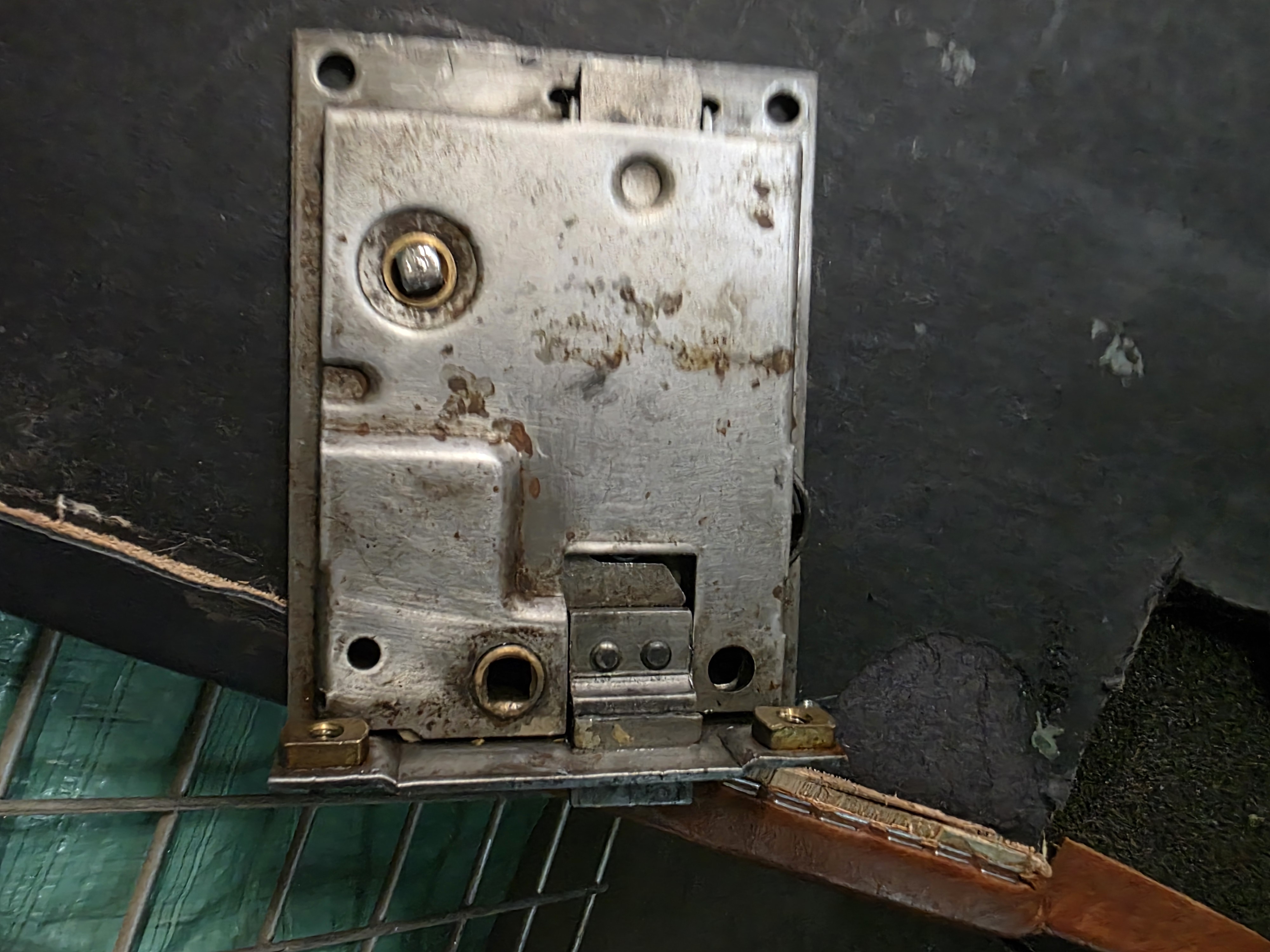

THIS IS WHAT HAPPENED

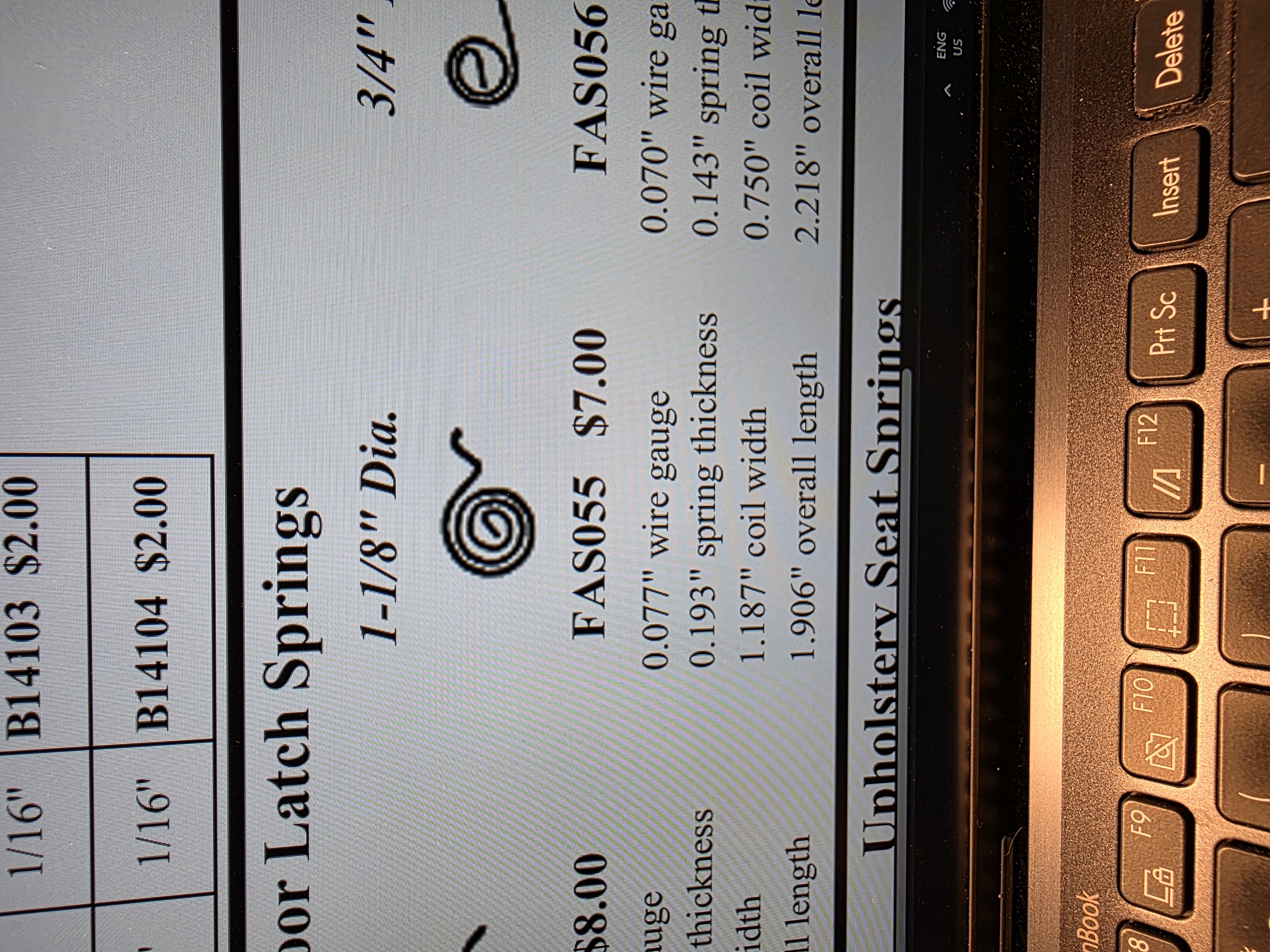

Just replace it. They are available. Try www.restorationstuff.com

RESTORATION STUFF-- has none in stock and cannot get any more they said.-- anyone have any other ideas??

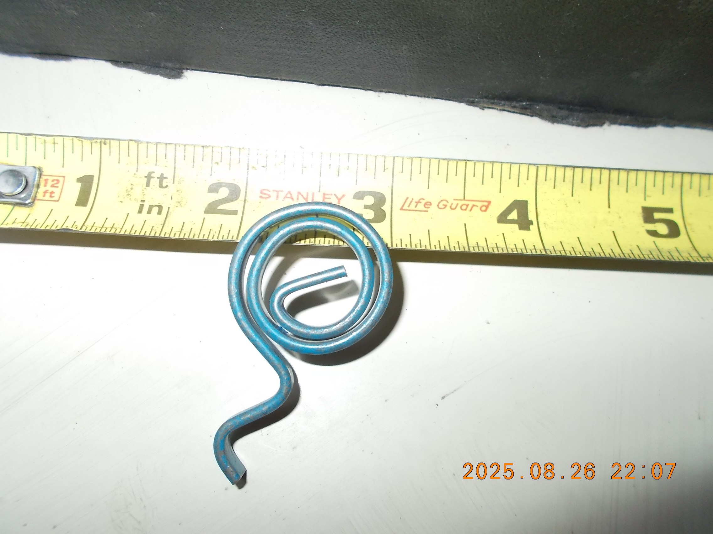

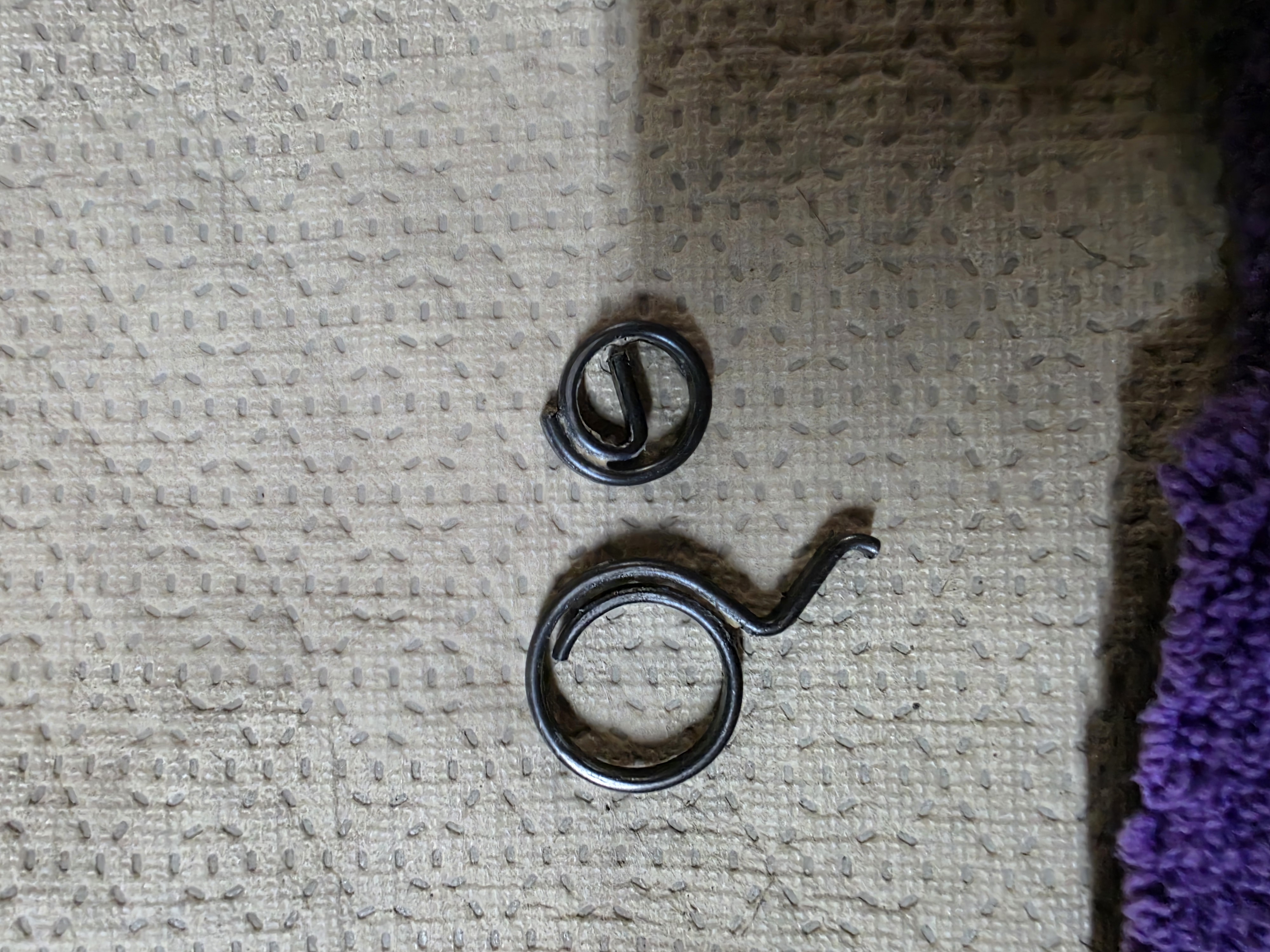

Here are photos of a selection I have - will need dimensions - Restoration Stuff seemed too easy - should have removed their offerings when out of supply. Will sell some - but can't at what $5 they had it? Don't know if I have anything that will work. Can you make out the applications? Gert

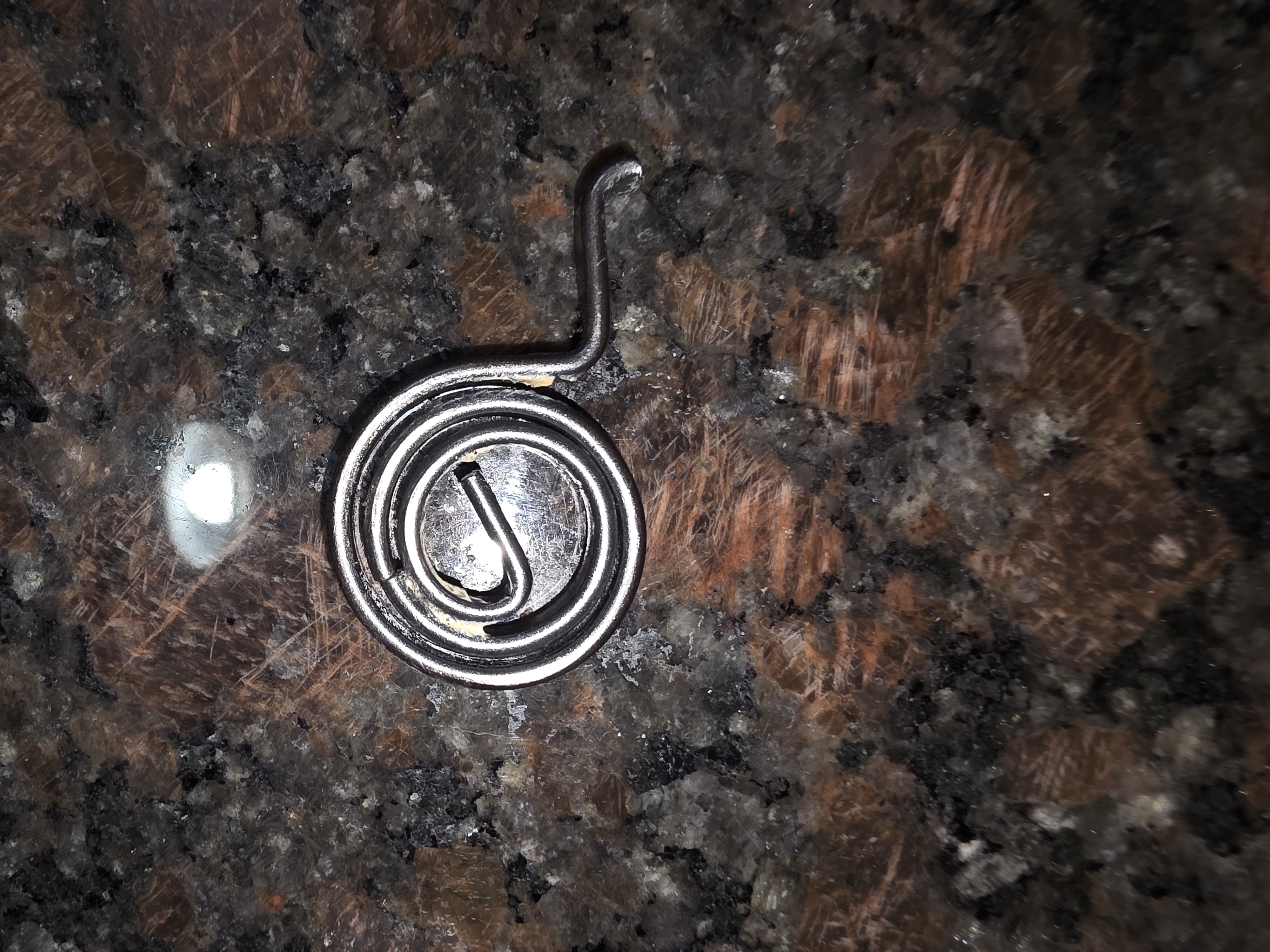

wow!!--you have a good selection.-- this is what i believe i need with specs.
it looks very close to the bright green one in your pic of assortments?
i would not expect you to sell it for $5-- if you think it will work, i will pay you what you feel it is worth?

i got one that was CLOSE so i used a brazing torch and bent it to what the original was
still works fine after 3 years
