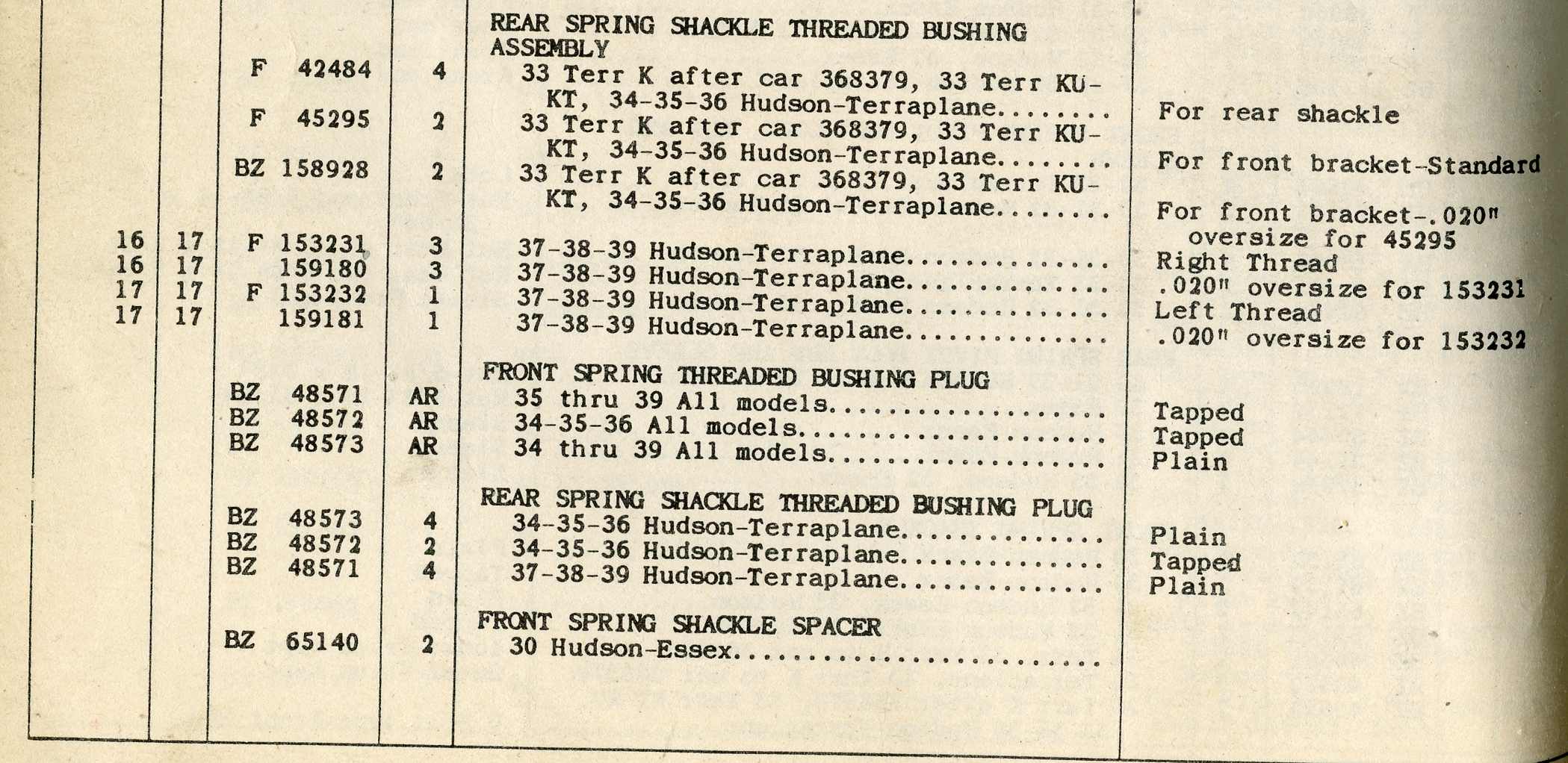

I need a bushing that screws into the shackle to hold the leaf spring to the frame in the rear. The bushing screws in with a 1" wrench. Any ideas on where to find one?

Thanks. It would be F 42484.
A specific part, not used on any other makes. This bushing is a unicorn

I had the head cut off of my old bushing, welded to a piece of tubing. the inside was then threaded to match the shackle. The outside got a light threading. The threads were worn away in the spring, making threading on the outside not important.
