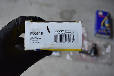

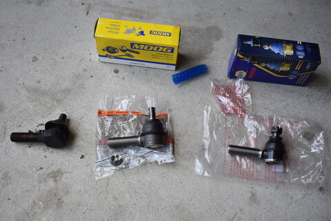

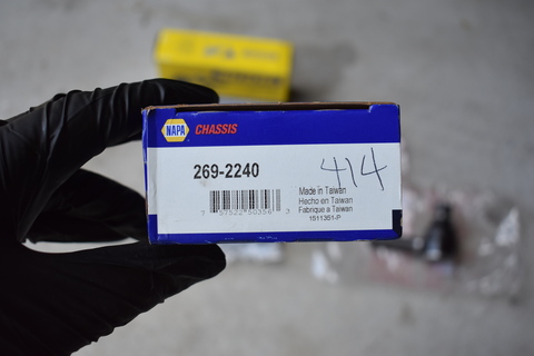

Hey there Vic! I just did my outer tie rods on my '53 Hornet a couple years ago. I also searched through this forum for the right part but forgot to post my findings. Above you can see my original tie rod end, a Moog substitute, and a Napa substitute.
I came across the Rare Parts number that you did and since they're kinda pricey and harder for me to get, I did a little shopping around. There are two other part numbers which link up to the same measurements and fitment: the Moog ES416L (and R for right) and the Napa 269-2240 series.
I really liked the Moog when I got it. It was made in USA, sturdy, and came with a zirc grease fitting. The Napa didn't, so I sent it back. The Moog installed just fine and has had a couple thousand miles on it already, so it's definitely a good fit. Also the Moog can be shipped free from Home Depot for about $20, or at least it was when I last looked.
Hopefully this helps with the outers. I honest can't remember for certain, but I believe the inners are the same.

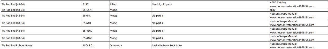

There are several listings for Hudson Stepdown parts interchanges on my website.
https://hudsonrestoration1948-54.com/
The following information is posted on that site and was provided by Christopher Chancellor

The Moog tie rod ends are the same number in the listing... Thank you as well!!
I had no idea they were also used for Fords.
