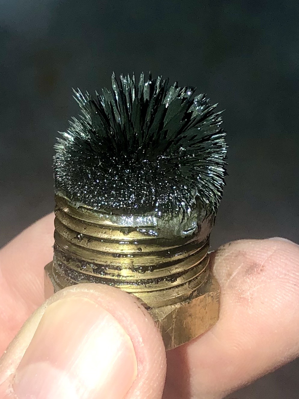

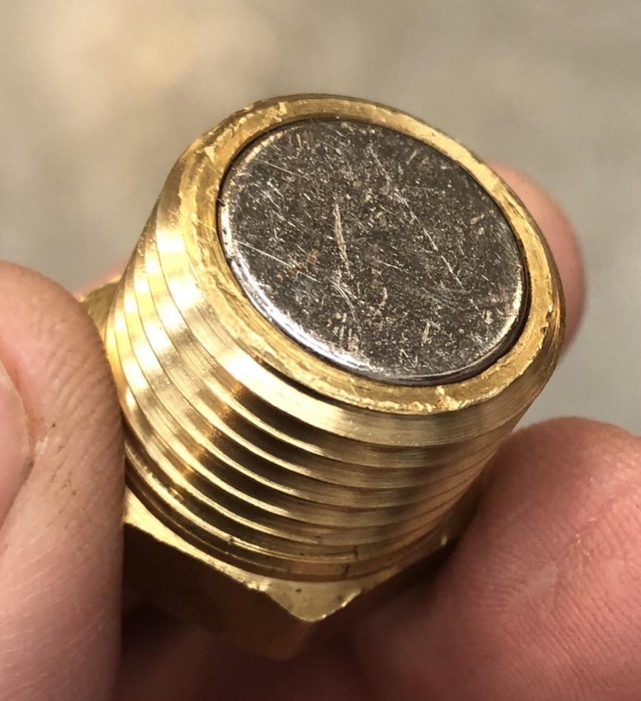

Thankfully I added a crazy strong rare earth magnetic drain plug when I rebuilt my motor that a guy in Montana sells & it’s definitely been worth its weight in Gold!
This image is at the 1st oil change at 200 miles from rebuilding the engine. Thankfully those particles were caught & not floating around doing damage:
After cleaning ready for reinstall:
Who sells these magnetic plugs and how much?
Who is the source for these magnetic drain plugs? I’d like to buy a couple.
