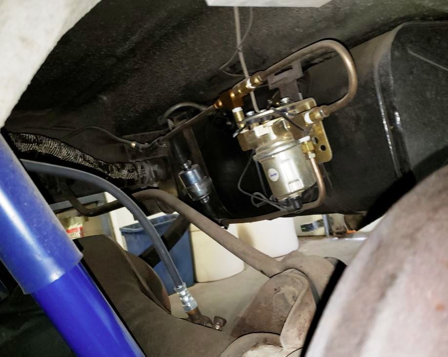

Hi everybody! I recently bought a Carter fuel pump and I'm trying do decide where to install it. I know it needs to be near the gas tank and also installed so that the electrical terminals are on the bottom. I have a '51 Pacemaker and there doesn't seem to be much room. I'd like to put it near the gas tank but I'm worried about possible interference from the rear axle and sway bar.
Is anyone using this pump in a Stepdown and if so do you have any pictures showing your installation? I would appreciate any insights or comments you might have.
Thanks!
The picture was sent to me several months ago. The Carter Pump is attached to the gas tank mounting straps. I have mine installed on the right frame rail.
I installed mine on a stepdown. Like Glowplug, I mounted it to the US passenger/right side frame rail where the fuel line runs. I put mine near the front foot well. Plenty of room there for it and a filter. The old Airtex fit well near the tank, but the Carter is so much bigger I gave little thought to mounting to the tank strap or near that area.
I've had zero issues with it drawing from the tank at that distance. I was concerned about that, but still no issues and it sure is easier to change the filter there.
