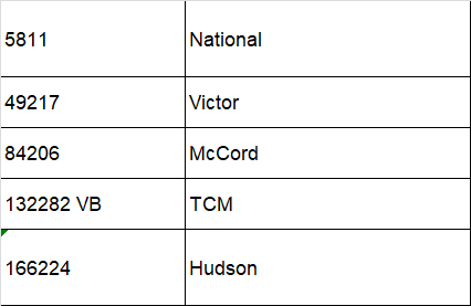

Outer rear seal can be one of the following:
Inner rear seal can be one of the following:
I am sure there are more. Inner seals are much harder to find.
