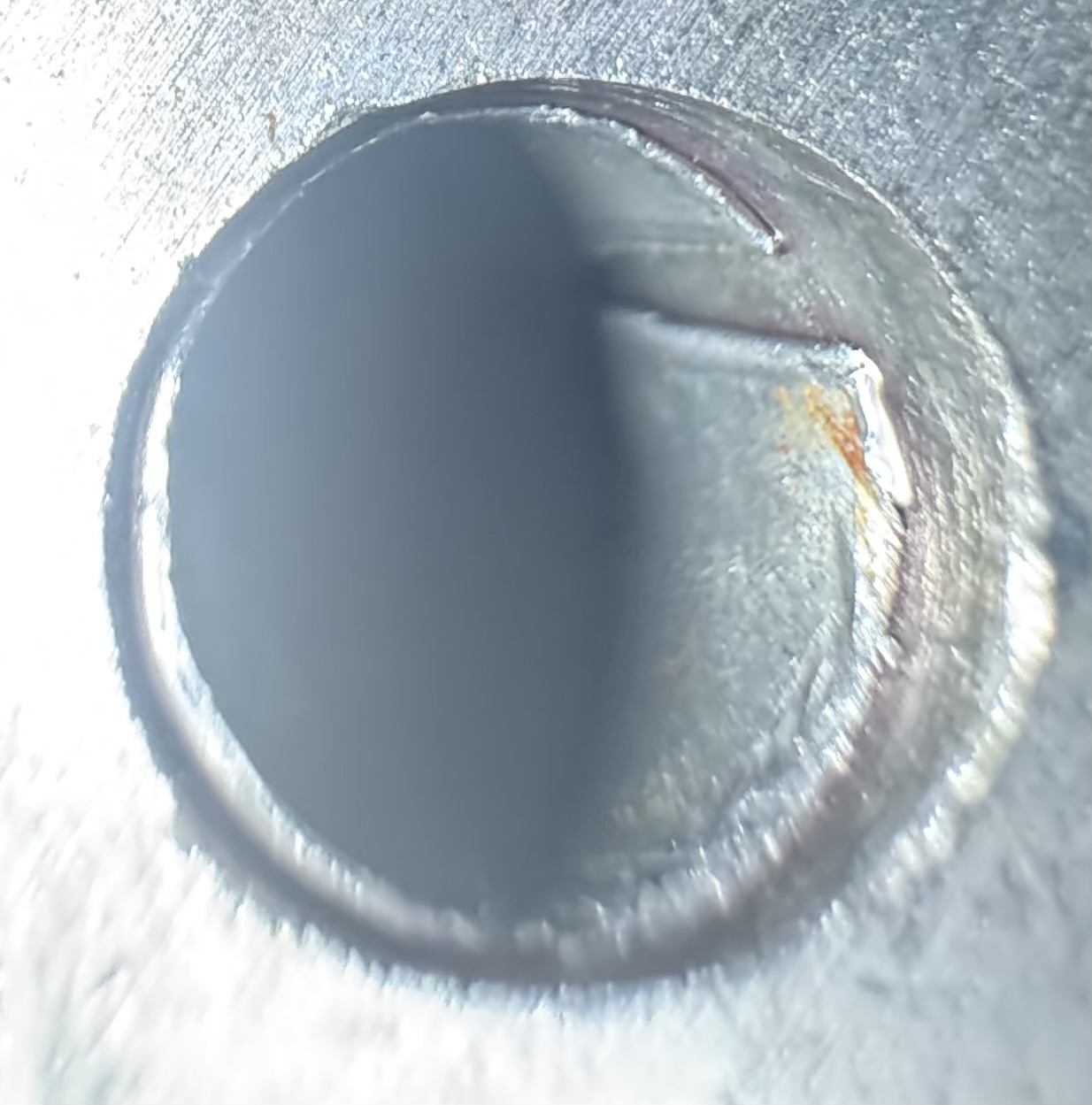

The check ball valve and spring were all present and installed in the correct order. My next line of thinking is the main line exhaust valve. Looking up into it the sleeve, I can see it is cocked and not square at the edge of the bore. The manual does explicitly call out the sleeve being driven too far into the bore as a potential cause for the issues I’ve been having by not allowing the valve to fully close. Being this is my first time inside one of these transmissions, I’m not sure what this should look like in a proper install. I’m including a photo in case anyone can tell me if that looks off or is how these are normally installed?
