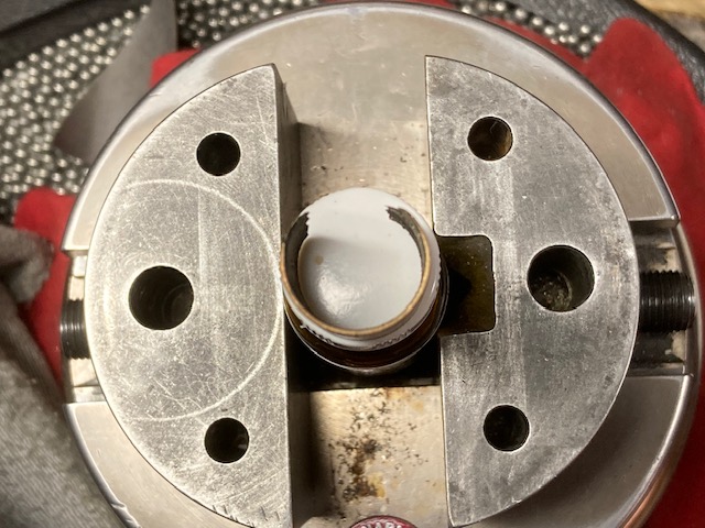

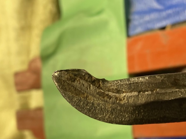

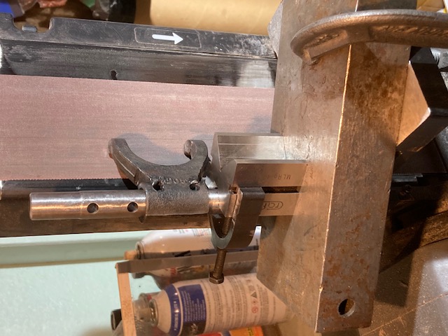

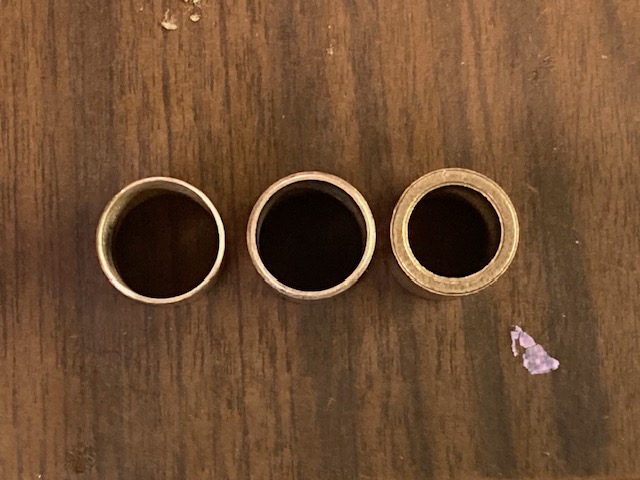

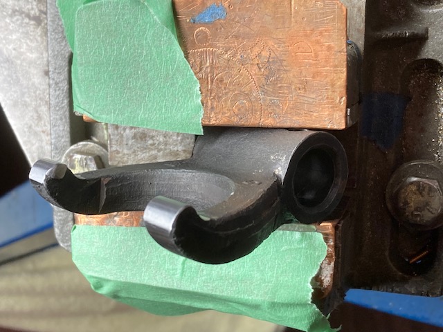

The throw out fork had worn flats on the throw out bearing surface. Found some welding rod for cast steel and torch welded them up. Made a radius fixture out of a v-block to put the curve back on. Machined new bronze bushings for the shaft. One to fit the new diameter of the end because the shaft had a worn spot because the bushing worn through. The other new bushing to ride on the centered none used part.
I did find some bronze bushing with 11/16" OD. But with an ID of 1/2". So the one on the "none used" part ended up with a wall thickness of only about .030".
