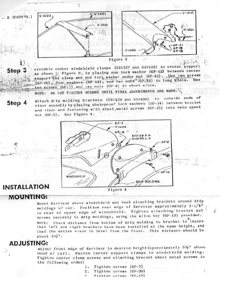

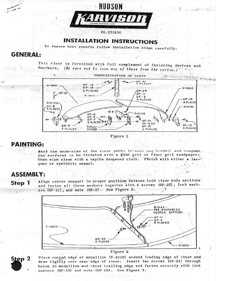

This is the only instructions I came across when I mounted the visor on my Hornet. I do not know which brand the visor was though.
Here you go... these instructions can be found on my website on the ACCESSORY page
Ken...this is exactly what I was looking for! Thanks for your help!
