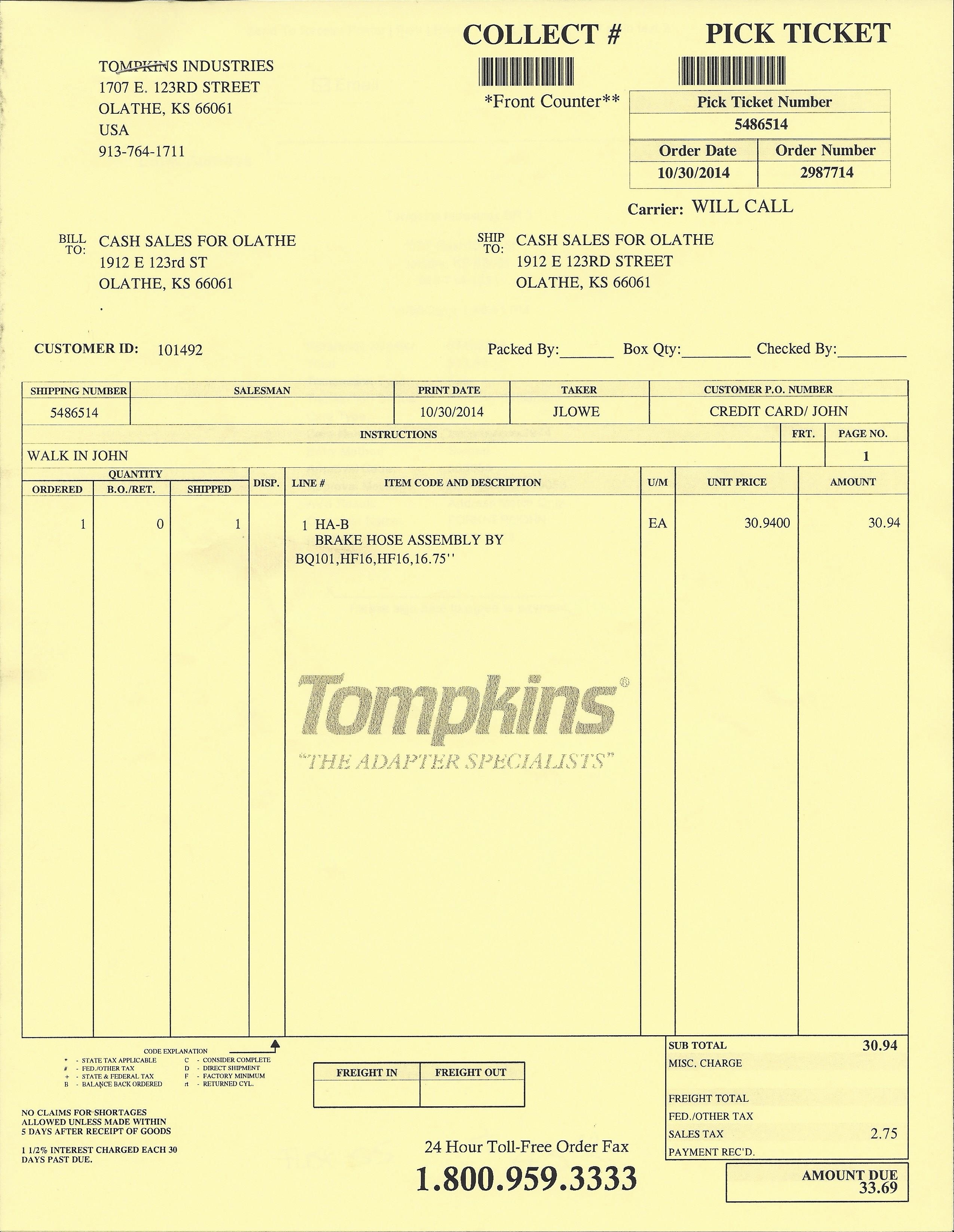

Take a look at the rubber brake hose that goes from the Treadle-Vac unit to the distribution block on the frame. If it is the original one from 72 years ago it has probably deteriorated and swollen on the inside keeping the brake fluid from flowing to the brake lines. I had a hard brake pedal on my 54, absolutely no brakes, then all of a sudden they would lock up! I found a company that makes new brake hoses that are DOT approved, Tompkins Industries. They have locations around the country and can make the hose up and mail it to you. Here's the invoice from the one that I purchased with the specifications listed, that's all you need for them to make you a new hose.
BQ101 - is the type of hose
HF 16, HF16 - are the style of ends
16.75" - is the length
