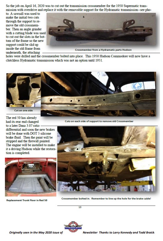

It's not a bolt in, but not a difficult conversion. The main thing will be altering the transmission crossmember.
Hope this helps. These pages are part of the transmission section found on my website. https://www.hudsonrestoration1948-54.com/ Ken Cates
