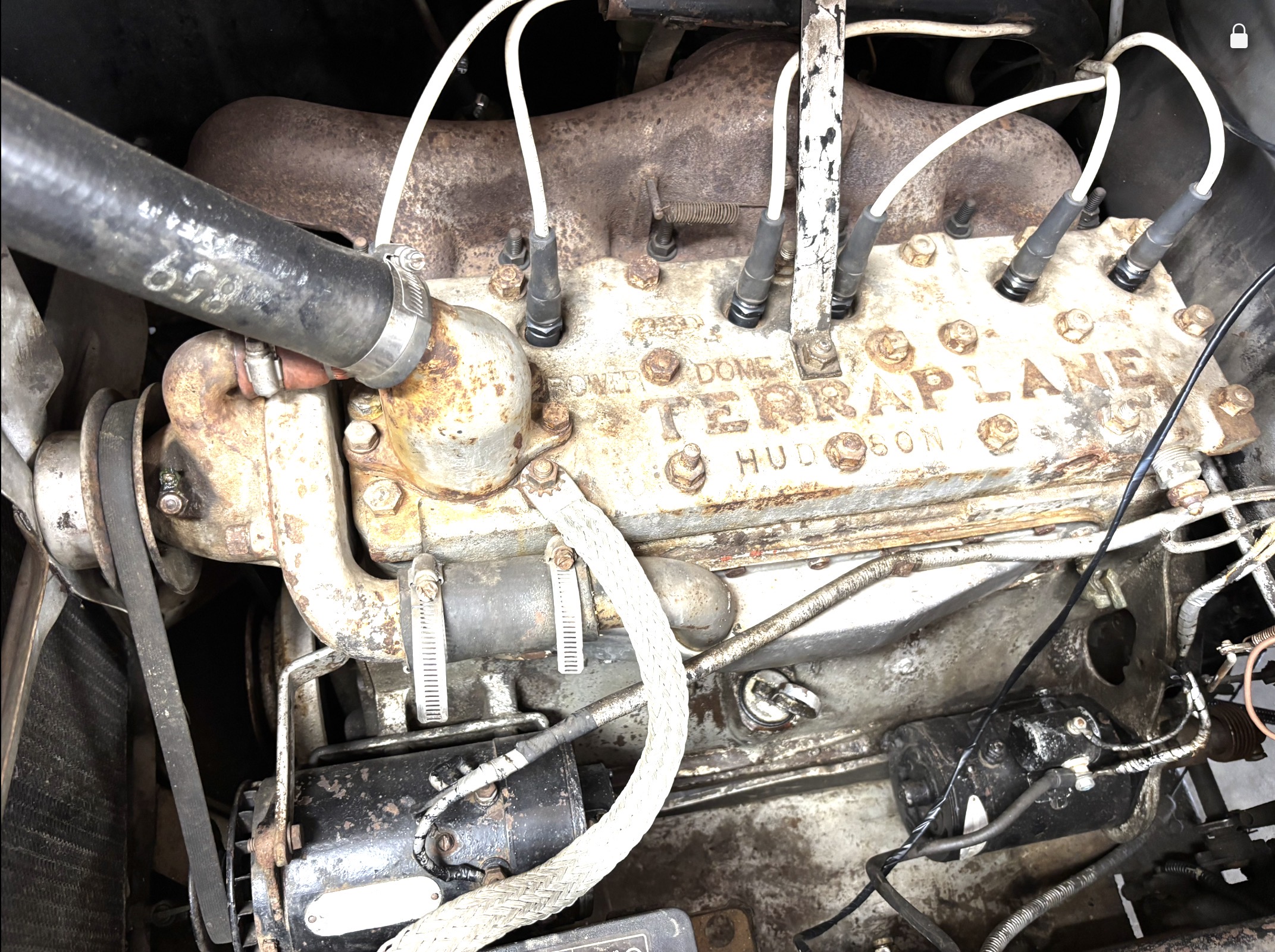

It is common for the water jacket on the driver side of the engine to be rusted out internally, and not controlling the water flow properly.
Outsmarted my iPhone by doing a screen grab of my existing photo
Thank you. I should probably disassemble the jacket and pump to inspect those components before I pull the radiator and have it rodded out.
While you have the water jacket off, look around the edge of the cylinders and see if there are pile of rust. There probably are. This should all be poked loose with a screwdriver and then shop vac' ed out.

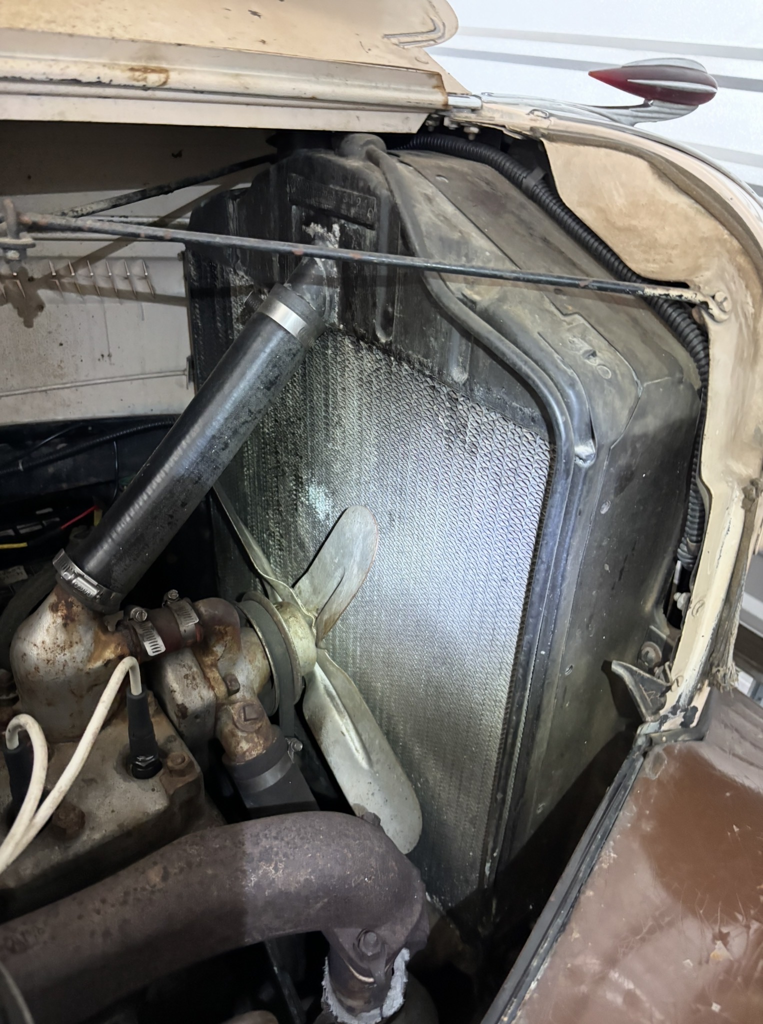

Can you actually rod out a honeycomb radiator ? Are the ‘37’s a closed cooling system? If not, there is no pressure to build, a new gasket would only stop coolant from sloshing out.

All good advice above. I myself would start by pulling the bottom hose off and stick a garden hose in neck. Water should flow out as fast as it goes in.
Many thanks fellas! It would make sense that you can’t rod out a honeycomb radiator. I did not realize these have that configuration. To my knowledge, the brakes are not dragging. I will order new points/distributor cap and points to be safe as I don’t know their age and will check the timing. When I get the time outside of my busy work schedule, I will perform these measures and report back. Thank you for taking the time to help me out.
