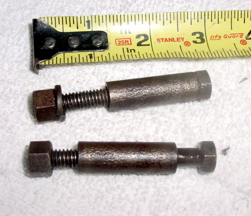

Why am I babeling about this? Because I have my own left over parts. I have the entire car back to together and a few days ago found the parts in the photo below (now referred as the Greg Brady parts).
Sick of trying to remember where they came from. Perhaps a buddy threw them in my Hudson parts bin to drive me nuts.
Any thoughts??

What you have are, 2 bolts, 2 spacers, 2 nuts and 1 lock washer Hmmmmm Must have lost the other lock washer.

Have you checked the hydrosolator? These bolts probably were probably meant to hold it together.0
From the looks of the items, I would say they were in the weather, under the car..How about a master cylinder mounting bolt set? Other than the muffler bearing support, thats all I can think of. Davew0
How about Rear Stabilizer mounting bolts?0

Dennis the bolts and sleeves are from the transmission mount.

I was about to say tranny mount fastenerss - that's what came out of my Commodore parting experience.0
I agree they look like transmission mounting bolts0
Okay, I was being facetious in my earlier post, but can you please explain how these hold the transmission on??? Or are they for an auto transmission? I sure don't recognize them as being part of the engine mount, or the drive shaft support.

Would help if we knew what model Hudson you have and what diameter are the bolts. 1/4"-5/16"-3/8"-1/2" 9/16" 5/8" etc etc.

Heart Of Texas wrote:Dennis the bolts and sleeves are from the transmission mount.
Ken
The Standard transmission mount is bolted to the cross member with this bolts. The cross member has a round hole cut on either side to allow the inserting of these bolts the nuts go on the top of the cross member.0 -
I Agree With Ken Now Either You Have Used New Bolts Or Your Transmission Is About To Fall Out I'm Hopeing That You Used New Bolts Lol0
Well that explains why the transmission fell out. I am changing my profile to Greg Brady in NY. Oh, for the record, I used new bolts. Or that is my story and I am sticking to it.0
