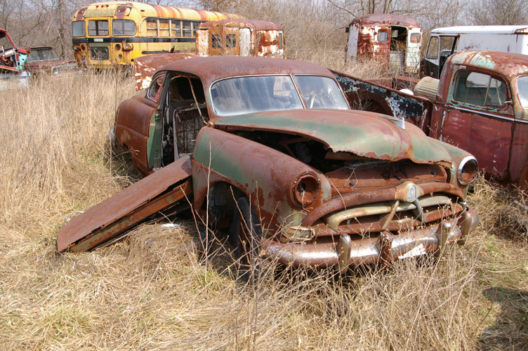

Looking for a donor section - check the main forum for pictures and details...or...http://www.classiccar.com/forums/showthread.php?t=9214
