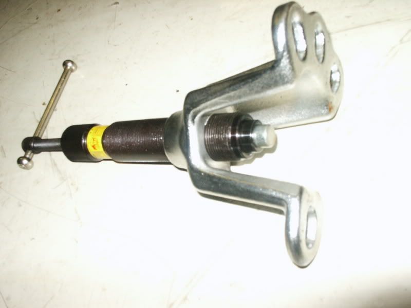

I was in a bind to pull the rear hubs on my 49 recently and couldn't locate
the puller I've seen pics posted of before so I settled for a hydraulic hub
puller I found at a local Chinese tool store. As spindly as it looked it managed
to pop both hubs with not a lot of force. I was pretty amazed actually and
will try and post a pic this weekend.

Promised a pic of my hub/drum puller. Although my drums have been off
previously they popped pretty hard when they came loose. I'm impressed
that just hand pressure on this hydraulic ram did the job. Don't know if its
the name of the company or the tool but it has a picture of some anteater
looking creature and the name Snark under neath it.
Interesting! Several years ago I bought a used version of this puller (well, mine has the three 'legs' like the one shown in Paul Schuster's illustrated 'how-to', over at the Hudson Photo Album site).
Because it did NOT have the familiar 'dogbone' anvil, which you could whack with a heavy hammer, I distrusted it. But the center portion is in two stages; you hand-turn the larger, outer bolt until it touches the end of the axle, then you start tightening the inner bolt by turning the chrome handle. This inner section has very fine threads and you have a LOT of leverage. It removed my brake drum with no problem!
However, up til now I'd never seen another puller like it.0 -
Yep, I'm guessing the handle end is moving a small piston to build pressure
and the axle end piston must be considerably larger to gain that much
advantage. Had to give $70 for this one though.0 -
