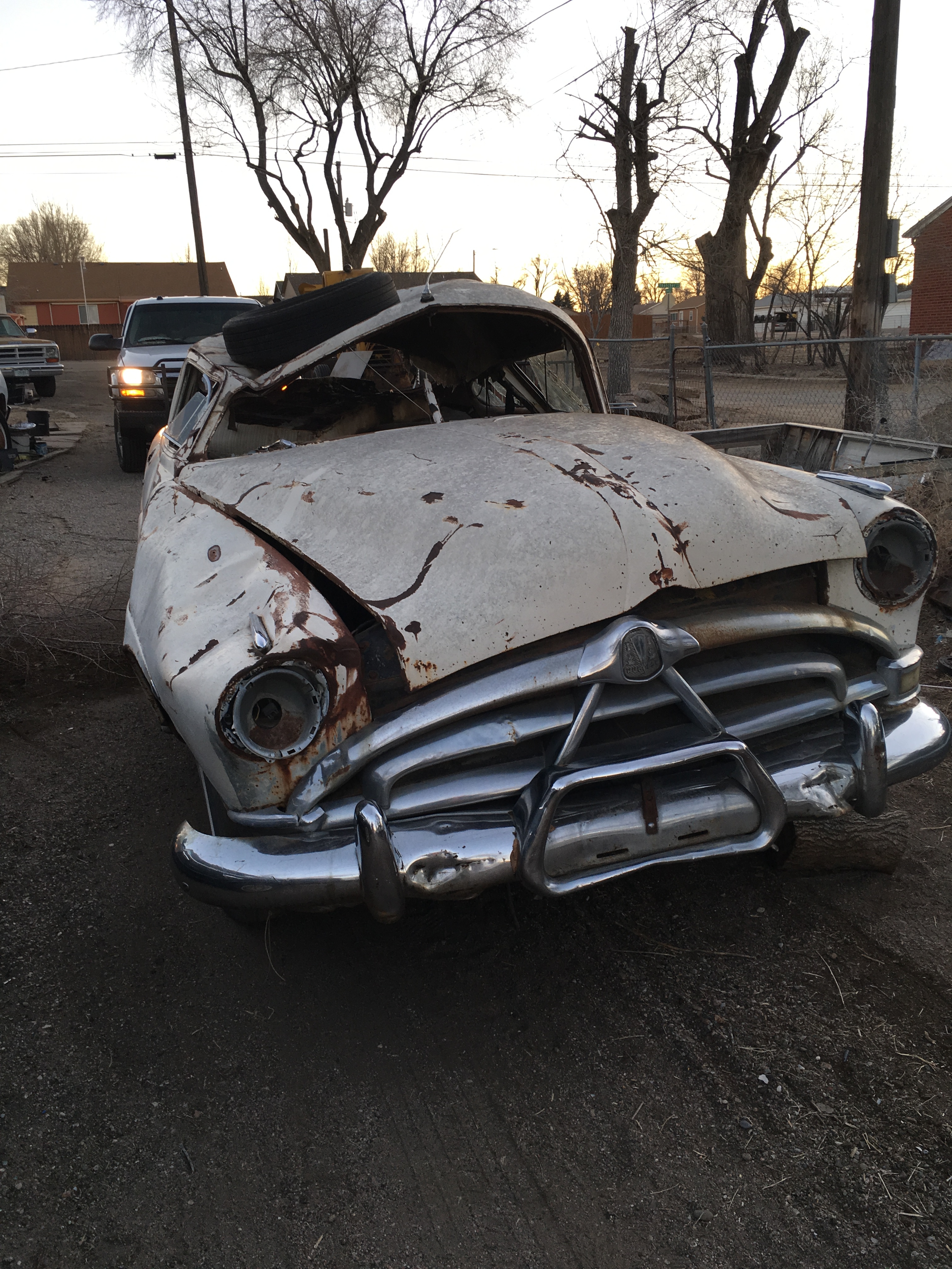

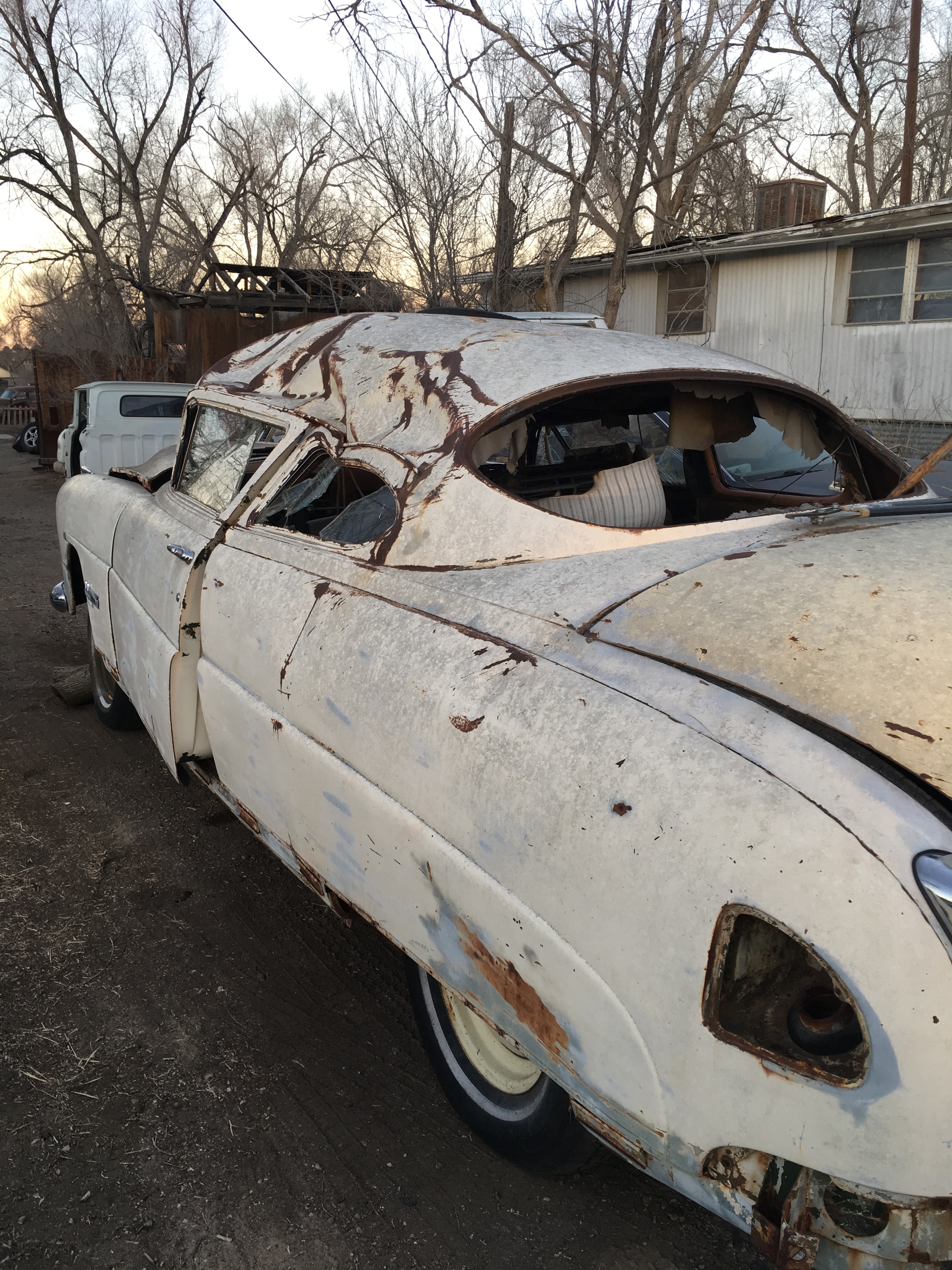

Don’t use a tow bar at ALL!!!! Here’s my 51 Hornet Club Coupe. Bite the bullet and rent a U-haul car hauler.0
