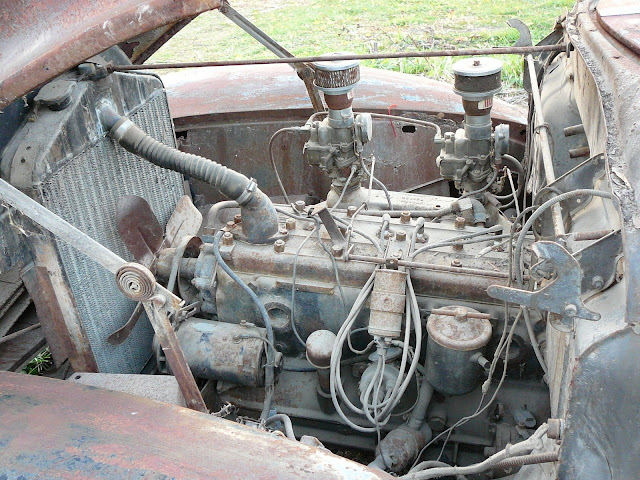

    The trouble with old pickups was they were used as trucks when they were in their prime. This one's had a hard life. Looks like the one next to it would be a better candidate.
  • Yea, but this one's got a 55/56 308 engine. Note 1/2" studs in head and boss for serial number on driver's side of the block.
    The Twin-H setup is from an earlier engine (separate balancing tube on the side) but it's also got a set of headers- looks like Clifford.
    I'll bet that thing was a sleeper when it was running.:)

    Well, I can't argue with that. My head has been so stuck in bodywork lately, I was mostly referring to the condition of the sheetmetal. Forgot to look outside (or in this case, inside) the box.;)

    Wow- I didn't think about the studs vs. bolts on the engine in the truck until a few hours after I posted. Maybe it's a 7X or at least a hot rodded home job?

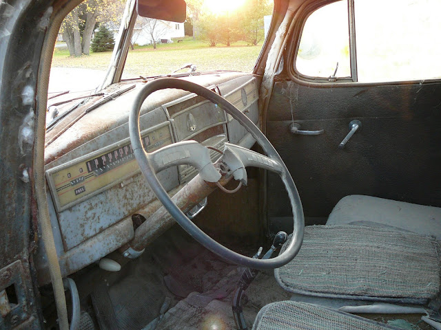

    Looks to be a '47, not a '46. Also doesn't appear to have the standard type of transmission (well, at least not the usuall on the column shifter...), see what's poking out of the floorboards?
    Looks like the topplate conversion with the overdrive switch taped to the shifter?
  • It's not as bad as it looks. At least from the outside. Good "Rat Rod" material, anyway. J/K.
