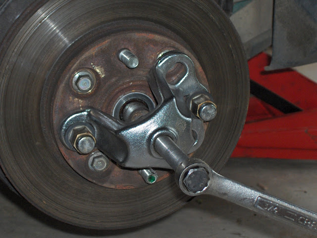

Here is the AutoZone puller, I believe: not quite as beefy as one might hope, but maybe it will work. I checked one website which says that they rent these out; it might be good to rent it just to see if it really works, then buy one if it does.
Here is what the "real thing" looks like:
that autozone one looks a lot like the attachment for my slide hammer. i may be able just to use it with a unf bolt and no hammer. i recognize the "oem" brand on it from autozone. the think that really annoys me is i used to have one of those in the lower picture years ago. i got it in a bunch of stuff at a auction. it was big and i thought "is this for a tractor, i'll never use this". i flat out need to be beat!0
Hi Hudson Dave here . If the car runs the easy way is to take out the key remove the nut and washer reinstall the nut and key NO washer Drive it around the block Left and right when you get back you will here klunk klunk klunk that means there loose :eek: If that dosn't do it u-turns in both directions will do the trick .:rolleyes: . Just like geting a head loses on the flat heads loosen all the head bolts just enough that the bolts are not touching, start it up and pop, up comes the head and the motor stops :eek::eek: work cool :)Hudson Dave0
If the hub is really tight on the axle the auto zone puller is a waste of time and cost. If I read the correct size of the wrench at 3/4 then the puller is not heavy enough to do the job. A couple of our Mid South members have bought hub pullers from J.C.Whitney that will do the job. MPP TOOLS also has a good one.0

If you do need to use a puller to remove your stepdown rear hubs, most of the modern ones offered for sale are just too light.
You need to have a really stout one with nothing less than a 1 1/2" centre bolt.
Most hire centres can help out if you don't want to buy one. Nowadays they all seem to have the hydraulic version of the hub puller, which is probably the better way to go.0 -
