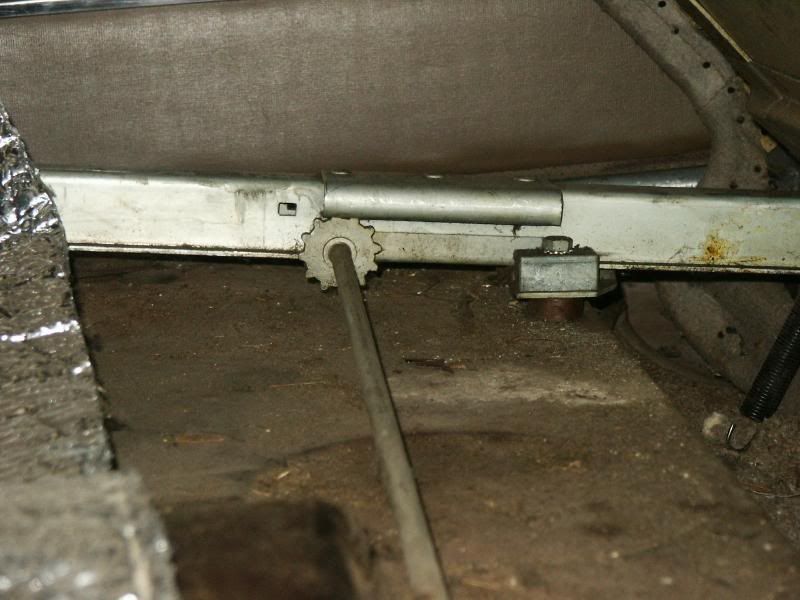

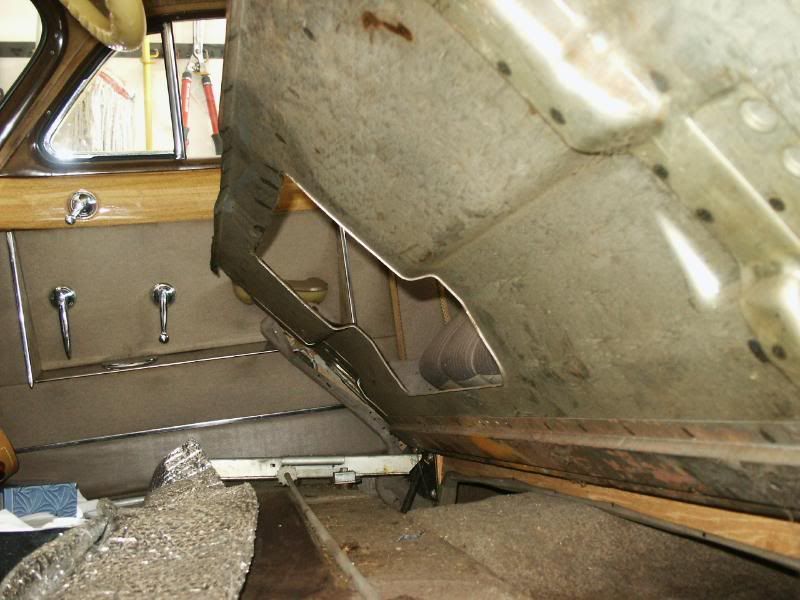

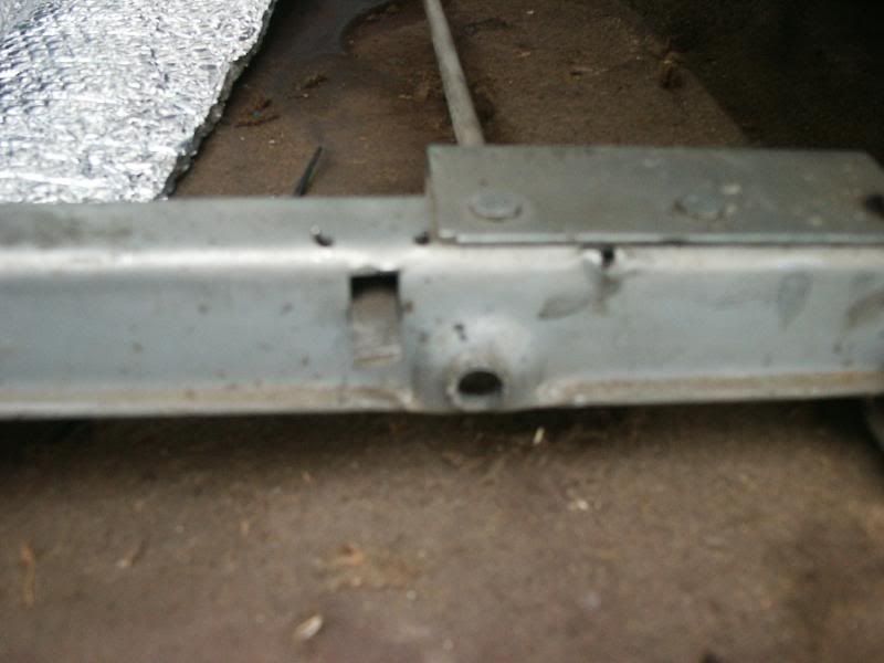

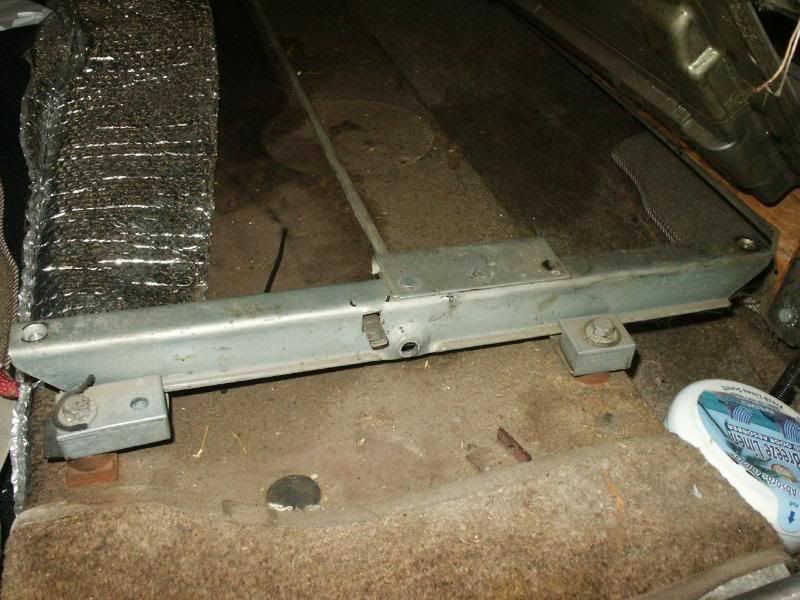

When you remove the seat frame, the lever stays with it. It fits into the 1/4 +-" hole in the outside of the left bseat btrak and can be seen in the photo.0
