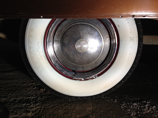

Thought I would bring this thread back to life. What BRAND of tire was original equipment in 49? Most manufacturers stuck with what ever company would supply the lowest $$ procuct. I remember my fathers new 56 buick came wirh US Royal. They were not on there very long until he replaced them with Firestones. From the published advertisements, the white walls were very wide.. but how wide? I bet Walt can fill in the blanks.0
SuperDave - Hudson always used Goodyear as original equipment tires. Yes the '49's whitewall was super wide!0
I have brand new, Goodyear reproductions of the OEM 7.1 tire that came with the car. The once I took off were the 2nd set put on by the first owner.0
On my 54 Hornet I have 700 x 15 ... the biggest white walls I've ever seen .0
All Hudsons came with Goodyears from day one. The 30's and 40's had the diamond thread. When they started white walls around 1946 they were 3 inch and starting in 1948 the white was 4 inch. Rub a curb and it took a month of sundays to clean them up. They also sold white wall flaps to put on the tire under the bead and when they flew apart, what a shimmy developed. Good only to 40 MPH. AH, those were the days. Walt.0

This is what I put on my 48 C6, Goodyear Super Cushion 7.10 x 15. The closest to stock you can get today!0 -

48 to 54 all had 5 inch rims with 7:10x15 in black wall or white wall. The convertibles had 5-1/2 rims with 7:60x15, also the hardtops. Again black or white walls. Radials size for the replacements are 215-75Rx15 for both rims. Bigger size tires are trouble, that is why some have split rim problems. Don't mention Coker to me or Press Kale. Walt.0
