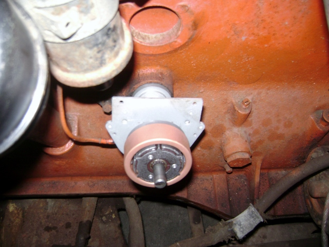

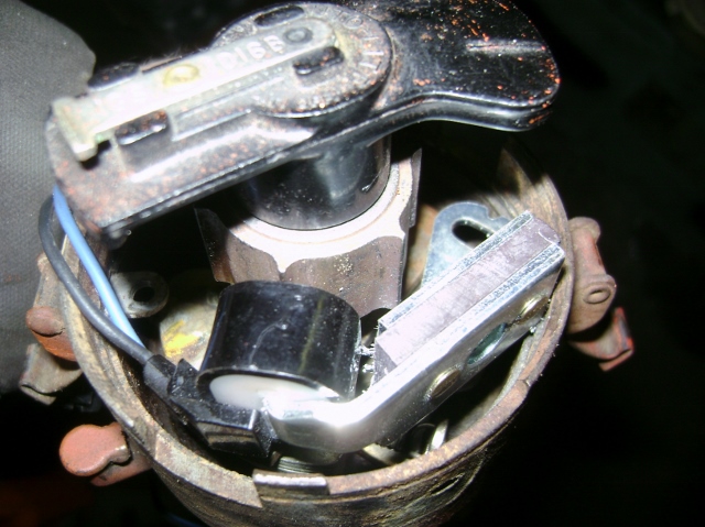

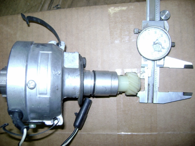

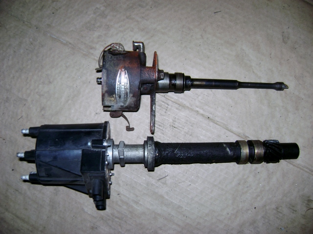

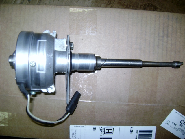

I'm currently running the mopar pickup to trigger my EFI.
Stock distr converted.
Dodge distr converted with lower Hudson shaft.
GM small cap machined for Hudson.
For EFI only.
