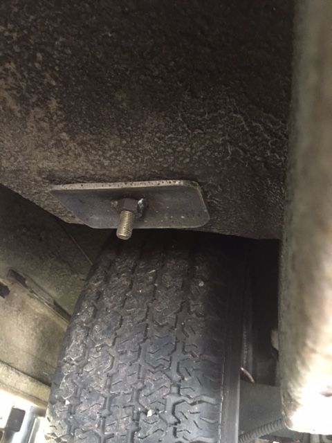

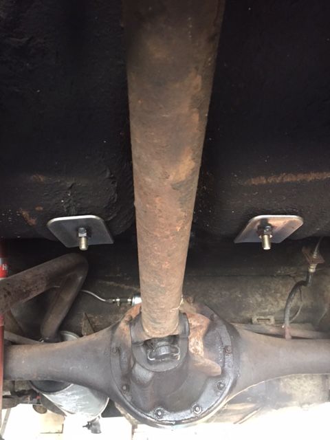

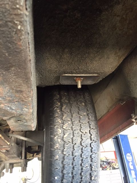

I took photos of where I mounted my rear seat belts in my 51 Hollywood. I bought the mounts on ebay and they fit perfectly on the flat area in front of the rear wheels. Ed Moore0
Looks good, Ed!0
Looks great Ed and that happens to be exactly where I ended up putting mine. The kids are happy they can now both go for rides!0
