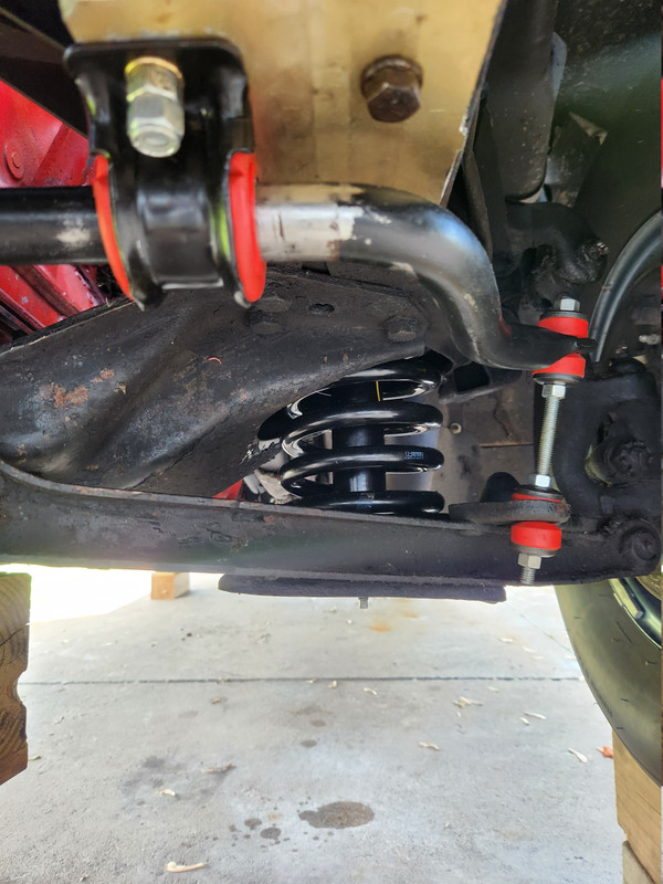

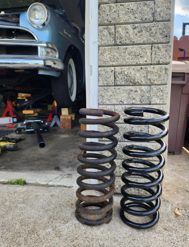

I did the coil springs today. I used front coils for a '84 Caprice it worked out great. After they settle in I might take off 1/2 inch to get the front 1" in lower. In the last months I replaced the rear leaf springs and now the front coils. Huge difference. Its amazing how much the suspension affects the steering.

Here's a picture of the Caprice spring next to the factory Hudson spring
